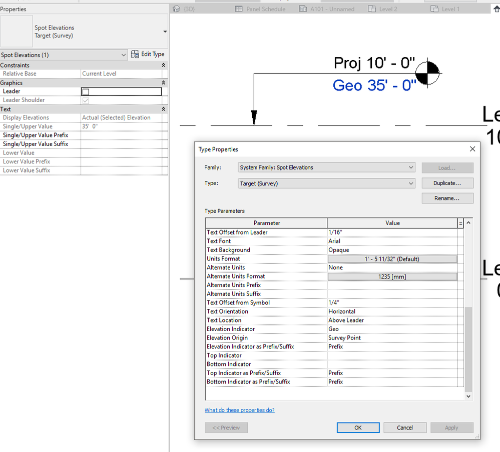

How to Display Geodetic Information Alongside Your Project Elevation
As the title says, I would like to be able to edit the level head to show both the project and geodetic elevations at the same time with a spot elevation. Any help would be appreciated.

Place two spot elevations, one references Project base point, one references Survey point.

I am wondering (haven't tried) if it would be possible to add a label to the level and then do a calculated value to calculate the difference between the two elevations.
if not, maybe you can make a second level that that is next to your other levels that report the other coordinates. I have done that and it works fine. You just have to be careful that you do not reference elements to the incorrect level.
