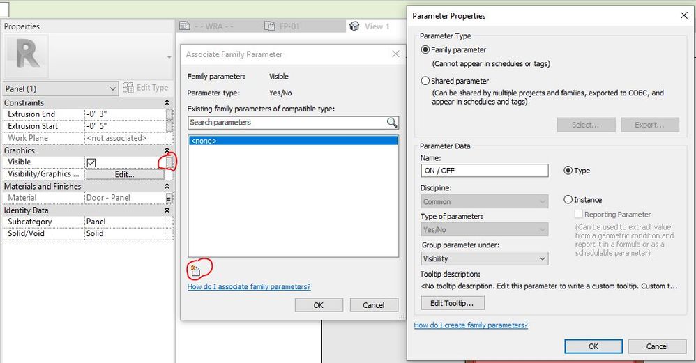

How to display an icon within a tag, connected to a yes/no parameter
I can add a label of that yes/no parameter, but then revit will return "yes" or "no" text in accordiance with the parameter.
Is it possible to display a symbol if this parameter set to "yes" and not display it when it set to "no"?

in this case i picked a door panel because that is what i had open, but should work with any element.
  • edit the family
  • select the item to turn on/off
  • pick the button to the far right of the visibility checkbox
  • make a new parameter
  • give it a name and group under
  • Ok, Ok,
  • load to project
