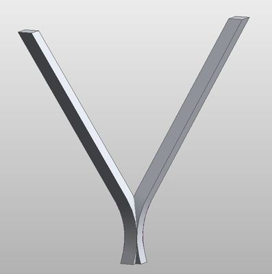

I'm halfway with designing this column, except I'm having trouble with the curvature of the column archs. Can this only be done using a structural-based program? Would be awesome to design this in Revit. Could someone mimic this and lead me through the steps?

I created this with the 'blend' tool. Yet it seems curvature isn't an option.

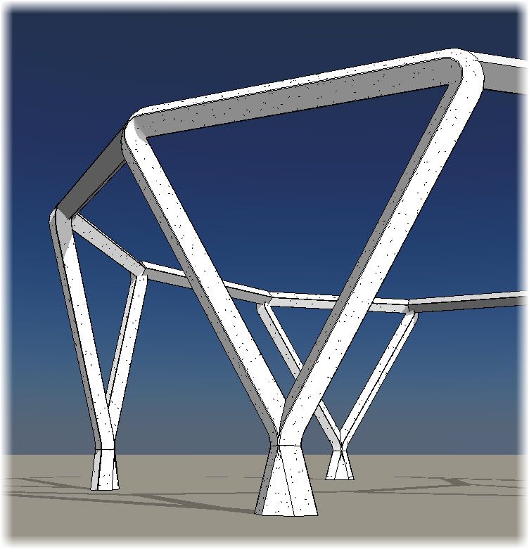

I think it can be done in 3 pieces, like this:
  • one solid by sweep on the left, "A".
  • one (mirrored) solid by sweep on the right, "B".
  • one solid by blend at the bottom, "C".
For making "A", you need a path with the curves and angles, and a profile, something like this:
For making "C", you need to draw boundaries for bottom and top, something like this:
Then,  define category, material, load the family into a project, repeat it, add beams, etc...
