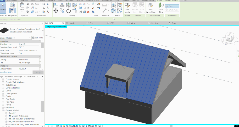

Greetings,
Is it possible to cut out forms like that, without breaking "roof group family"?
I tried "Void forms" but they are not making any cuts?

You only need a Void ... modeled in a Face based generic Model
For the added BIM Value and if quantification is required...you can set the nested standing seam panels to shared ... then you can schedule their quantities and dimensions (assuming that the latter are shared parameters)
An Alternative method you can use without Voids or cuts or shared families is Convert the Standing Seam Roof Generic Model Family to Parts ... This will allow you to
  1. Treat each panel individually using Shape handles
  2. Splitting and excluding parts of the panel at the intersections with walls
  3. Quantify the panels using Parts schedule
  4. Get the cut pieces measurements from the excluded parts
See GIF below:

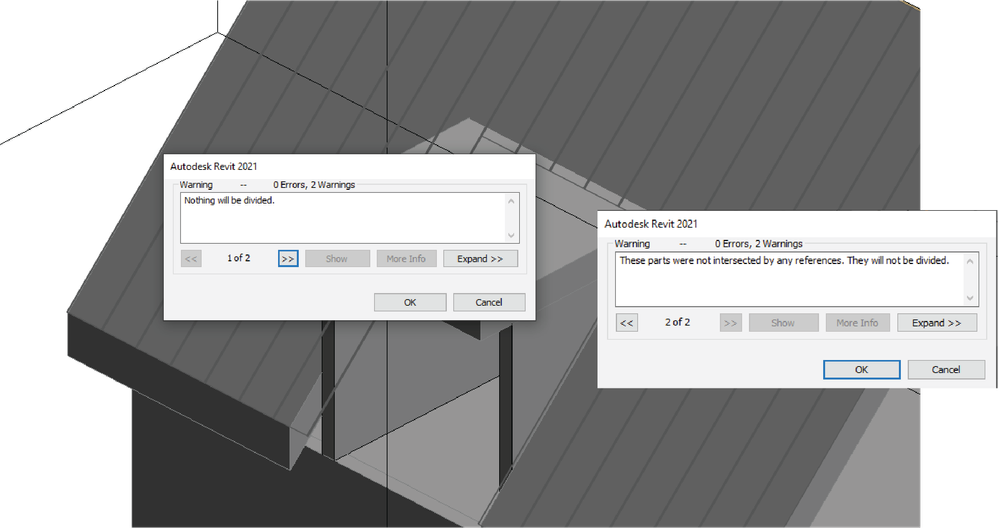

Yes that's 2nd solution is what I was looking for for this roof.
I don't understand why I can't "Divide parts", what I'm missing?
And will be there a way to group them back together later?

@cadedu22
  1. Make sure the right workplane is set (the Standing Seam plane)
  2. (On the outer side) Pick the edge of the wall from the outside
  3. (On the inner side ) Pick the inner side of the SS Panel then drag the sketch line slightly outside the panel
  4. At the top Pick the edge of the Panels you dragged up
  5. the bottom simply pick the edge of the panel and drag the sketch slightly outside the panel
  6. connect the ends around the wall using pick line
When the division is done properly you will see the sketch lines turn green when you exit sketch mode
Do not group them,,, Once done >> Isolate category >> select all except the excluded parts and Assemble them See GIF below

Divide Parts at Intersecting Level and then Exclude Parts to remove the ones at the opening.

Yes, I didn't notice that some how my "Constraints" base level was not Associated, I set it to any level to match warplane, and it's fixed allMissing.png
