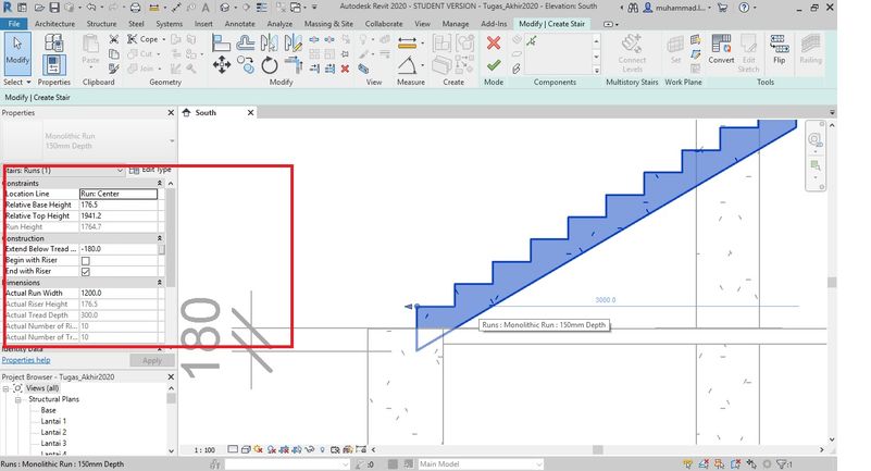

Hi Pal.
I started learn revit and I need to create stair for my educational project to calculate the volume percentage.
I have some problem to create some stairs with different riser height
the first riser 170mm and the rest  180mm (10 riser left)
view from topview from top
view from sideview from side
it's my first time creating stair with defined dimensionit's my first time creating stair with defined dimension
if my question has benn qustioned.please give me the link
because i did'nt know the keyword
Thanks. God bless you all

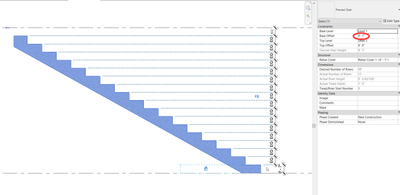

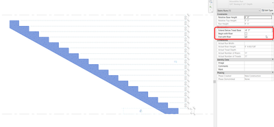

Were my screenshots enough?
1. Enter 180 for "Base Offset" Parameter
2. Edit Stairs and uncheck "Begin with Riser" and then enter "-180" (MINUS 180) for "Extend Below Tread Base".

Message 8 of 9
Press the Green Checkmark to Finish and Close Out of Edit Stair Mode, and then select the Stairs and look for "Base Offset" Parameter under the Stair's Instance Properties.   Enter 180.
File Attached...
Message 9 of 9
muhammad_lailal_muharromi
it's work
watch your attachment , i realise that i need an added level that refers to the landing
Thanks for the help sir
