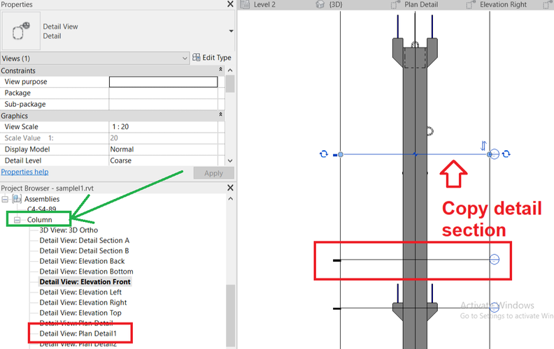

Hi All,
I am able to to create all other views of assembly except Sections.
Seems I am missing some step to get desired result.
If anyone knows a right tutorial video/knowledge about this, Kindly shed some light on this.

yes, I have done that for other views & its working fine. But, its not working for Section.
how to control the section plane in these options?
I need a section cut horizontally to the column (as shown below), but I get  vertical section as default.
Hope my explanation clear to you. thanks.

I want to make horizontal section across column, but not able to do using present "create assembly view" option!

I am curious have you try copying the existing detail section and place them at the upper column. It seems to keep the detail view as assembly.
Nachricht 11 von 14
shuaib009
als Antwort auf: shuaib009
hey, thanks. But how you are able to get this  (highlighted in green)
Usually after I choose "Create Assembly Views..." I get all selected views under element ID!
I get like this! what can I do?
