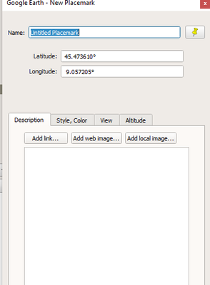

Hi, I am having problem with using Google Earth coordinates into Revit. I am not sure what is the format of coordinates used in Revit.
In picture 1, there are settings in Google earth

Use a tool like this to convert lat/long to Northing/Easting:
https://www.latlong.net/lat-long-utm.html
Cut and paste the Northing number into "picture 4" in your post under "north/south" and the Easting number into Eaat/West.  Also fill in the elevation if you know it for your site.
Angle from project north to true north can be zero, and you can establish this again later if you need to.
