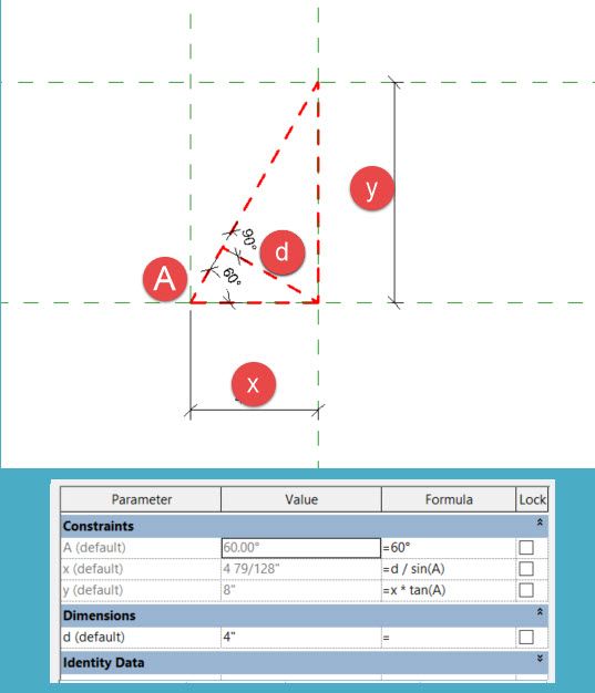

Weak or Strong reference does not have anything to do with a reference plane moving or not. What exactly are you trying to do, some kind of star? Or a pattern?

You need to build the skeleton of references in a different way because you want to control the figure by the distance between the long diagonals. That distance (d) is one of the sides of a small triangle at the base. Using that distance (d) and the angle (A) of 60 degrees, you can find (x). Then, knowing (x) and knowing (A), you can find the total height of the pattern (y). Then, use those those values to complete the skeleton. Then, draw the reference lines from intersection to intersection. Then use the reference lines to create the surfaces, solids,  or filled regions that you want to create.

@m.pharamawy Did you see post # 5 above? That "d" parameter changes the size of all the triangles.
Depending on what you want to do, it might be easier to use a divided surface with a pattern, if you want to increase the number of triangles, not just the size of the triangles.
