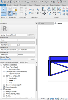

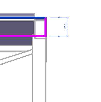

Does anyone know how to change the settings or make it in inches in this downloaded model that I modified?

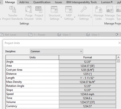

Manage Tab=>Project Units.  Change to the units you want.
...BTW: there is nothing you need to do on your end if you're handing the model over. The end user can change Project Units on their end.

Manage tab=>Project Units

What was the solution, @jgarciacorpus69 ? A PICTURE of the Project Units dialog box???  Strange. I thought you asked: "how to change measurement settings".  That's the question I answered.   I even provided a roadmap. Manage tab=>Project Units.
