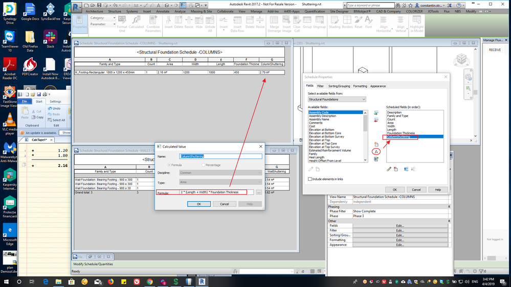

My question is how to calculate with Revit formwork areas for footings.

use  Calculated Parameter Fields:
  • 2*(L+W)*T   for Column foundations
  • and 2*W*T for Wall foundations
  • use Filter to isolate Wall and Column foundations
  • have a look at the attached file

How can we model formwork in order to calculate area for footings?
columns and walls ok, but what about footings, strip footing?
