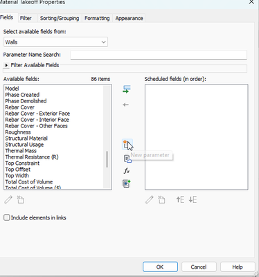

@pfariaKP97U  I think you can create your own Wrapping at Ends parameter but I dont know how would the wrapping part be included in the quantities since is just for appearance? Maybe if you add the Area as a formula for Wall thickness x Wall height?

Well, but how would that work? how it would actually calculate the wrap areas?

This field is not available. How can I do it?

You would need to create a new parameter and then a formula. The wrap area would be Wall thickness x Wall Height. Bu that would be an aproximation for wall ends. If you have 2 ends then multiply again by 2. This should be done just for the walls in that situation. I dont know how you can do it for inserts like windows or doors.
