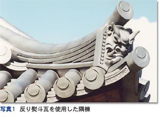

Hello
Please advice how to array and stack tiles on a curved roof ridge,(more complex than 3D array repeat on divided path),
please refer attached pictures

You can do this in the project with the Beam tool using 3D Snapping and Pick Line and picking an model or mass edge.  That sound like something you would like to do?

Stack different masses and create walls by faces.  Or just create a wall type with multiple tile layers, place it by face, and use a void or a mass to cut it to shape.

Hello friends @ToanDN @barthbradley
I have to make it in a form family (no Beam or Wall), not in project,  because the ridge "beam" has to be made in "form" and follow many layers of roof forms (curve joist etc),
attach is self-adaptive ridge form family, which will be adapted along the edge of on various form (the red line will be the line of repeated ridge tile)
I am setting layers /face now, and Please advice any approch then I try

progress....using pattern, first layer.
