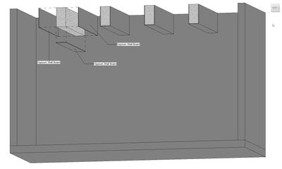

als Antwort auf: Anonymous
@Anonymous wrote:
 I've succeeded in adding plaster to column but I can't do the same to the beam
Why not? We do it all the time. Model it in Revit the same way it will be constructed in the field.  Wrap the Beams with Walls and Floors or Ceilings that are the thickness of your "plaster" material.
