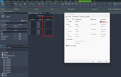

you can use the sorting and choose the sheet number and check the Blank line:

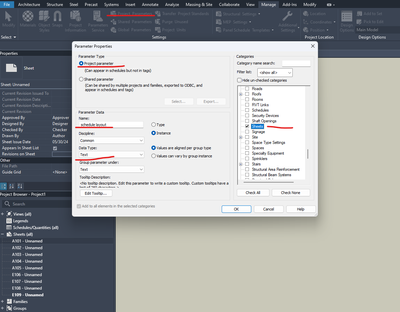

if i were i use the new variable like "schedule layout" and give him the value like A,B,C,... or 1,2,3:
give the variable your value:
then you can use the "sort by: schedule layout" and hide the column C like the attached image:
and now you have this :
