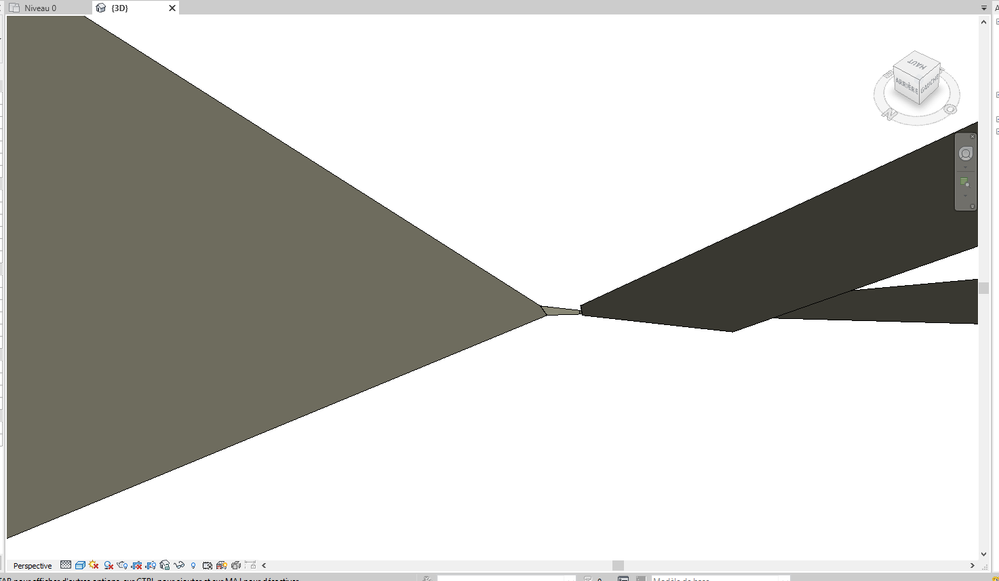

How do you change focal length in perspective mode in Revit 2019 ?
I put Revit in perspective mode (by the way : THANK YOU FOR ENABLING THIS ! It was long overdue...)
However the focal lenght is very "large", the angle is too high. How do you control this ? I can't seem to find it in options...
How to change focal length ?How to change focal length ?
Cheers.

Agreed! A long overdue update! anyway to change the focal length bring up the 3D navigation wheel and click the drop down in the bottom right corner. should let you adjust the focal length from there. Hope this helps!  FocalLength.jpg
