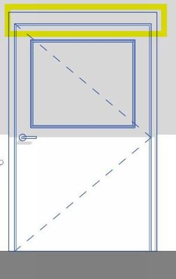

This 'Door-Passage-Single-One_Lite' family doesn't have an even frame, so I would like to know how to remove the frame &/or be able to adjust width parameters uniformly on all three sides? Thanks for your help.

FYI: That frame is for CMU wall so the head is taller to accommodate the CMU module.  You can select the Door in the project and choose a different Frame option from its properties.  You don't even need to open the family to do it.

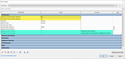

To remove the frame entirely from a door Instance in the Project, create a couple of more Yes/No Parameters and enter the Formulas shown in this screenshot into the existing Yes/No Parameters.
Nachricht 5 von 8
evernewjoy108
als Antwort auf: evernewjoy108
Thank you very much. Such a simple tick and yet I spent so much time trying to manipulate the family.
