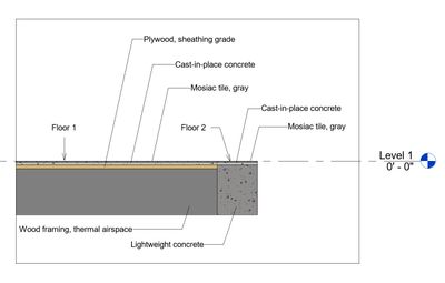

Hi experts!
I would like to extend the floor finish layer up to the wall limit.
How can I do that?

Looks like you need a thicker Floor.  Make the floor you have thicker or add another floor type, that is the thickness you need, on top of that floor.
...there is also a Height Offset from Level Parameter. It won't add thickness, but it will raise the floor.

I want to extend the floor's finishing over the wall.

I think what you want is to draw the floor sketch up to the outer edge, then use join geometry. If the layers functions are set correctly it should join properly, or possibly you'd have to switch join order.

If you want to do it that way, you need to edit the floor and extend the sketch boundary so it overlaps the wall. Then you can use Join Geometry to join the two.  I wouldn't do it that way. Have you tried any of the approaches I suggested?

Okay, then create another floor type that is 0,0045 thick Acabament only and place it on top of the wall, and then use Join Geometry to join the Acabament layers together.

Create Parts from the Floor and then you can extend the Layer.

But my problem is that the floor thickness has the same heigt as that wall. So, when I extend the sketch boundary the wall is deleted. 😣
Message 16 of 30
It's not deleted. It's there. You just need to Switch the Join Order.
Message 17 of 30

But seems that you created two floors....
Message 20 of 30
@DaviMeloPereira wrote:
@barthbradley  escreveu:
Yes. I'm doing exactly what I described to you in message #9.  Something wrong with that approach?  It's the one I would use.
