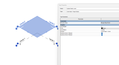

How can I show levels on the front face of my model in 3D view
Right now my levels are shown behind the model
How can I show these to show at the front of my model like I have drawn in Red
Regards,
Aidan

There is no setting for this.
The only way you can accomplish something like this is making use of model lines (or create a family for this)
The disadvantage of course, is that these are model elements so will show up in all views. Then you need to filter them out in those views were you do not want to see them. So seems a lot of complications for this.

Maybe easiest to create a new linestyle (Manage > Additional Settings > Line Style), name it something like LEVELS. Set the appropriate line pattern, weight and colour.
In your views you can then deselect these lines in your VG, under Model Categories > Lines > LEVELS

Thanks for the advice
I am still stuck on trying to show lines in this 3d view
I have a view template with model category > lines , all on
but still the visibility is hidden.....

The problem is I dont know why I can not see my model lines appear..
I have been given the warning: None of the created elements are visible in Floor Plan: Nivel 10_T View. You may want to check the active view, its Parameters, and Visibility settings, as well as any Plan Regions and their settings.
I have checked the VG settings, all lines are turned on...
I have checked the active view, the lines are drawn within the active view..
I dont understand why it wont show them

The message means that particular (sub)category is hidden somehow. This could be your VG settings, also check if filters are active that might have hidden things.
To check you also can create a new view and see if they are visible there

They were on an invisible workset.. all fixed now
