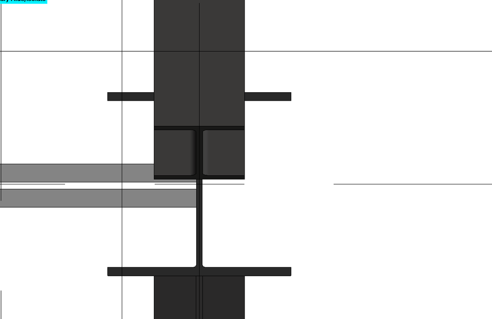

hi, could someone please give some advice this is driving me nuts:
Whenever I drag the structural Framing component end (blue point) that end gets an elevation. Is there a way to do this change in plan view without getting an elevation on the end of the Girder.
As you can see I am trying drag the component end (Bluepoint) to be aligned with the center of the column, or with the grid. I'm having a struggle with the snaps as I get a lot of symbols.
once I drag it to the center of the column, that specific end immediately changes elevation, when I'm just draggin it in a plan view.
This is How it looks in 3D
I tried the following:
I really don't know where is located on the intersection of grids or in the center of the column (Located in the same place) I'm Kind of confused

It did work in sections and elevations, I think is the less stressing method, because there are fewer snaps.
The amount of snaps is insane
I tried again in the plan view I checked each snap by hitting the Tab key and got the following results:
It did not work on the following snaps (I got a diagonal beam with an elevation at the end of the element 👎😞
However, with the following snaps, it worked perfect, no elevations on the end of the Girder 👍:
the intersection (X) and the square 🔲 gave me the desired results. The intersect snap is placed on the intersecting grids as well as in the intersection of the column's horizontal axis with the vertical grid. the column is located in the intersected Grids.

david.segovia
Not sure if you ever got your answer, but if you use the extend tool it would work better than trying to pull with the blue grip. Those blue dots have a tendency to snap to the end point of the columns, which looks like it goes pass the floor level. Click extend tool and select mid-point or intersection of column and select the beam you want to extend.
