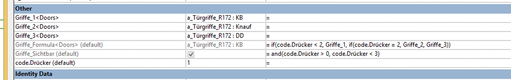

In a door family, I have a numerical parameter that contains a number that determines whether the door handles are standard handle bars, knobs or public building type bars or combinations of any. The number 10 would select a standard handle on the inside and exterior sides of the leaf and leave "DD" in a shared parameter that is used in our door schedules. To have this same parameter also choose the family type of the door handles, I tried to make another if(condition,this,that) formula but ran into a 'Inconsistent units' error.
How can that be fixed?

You re gonna have to forget about the family/type parameter. Associate the nested family parameters with the host family parameters. Then, you can play with the formulas. Those can be put in the nested family or host family (depending on your strategy). The idea is to have yes/no parameters which constrain the geometry visibility while having formulas like:
code.Drücker=10
Based on what I understood while reading your post and observing the family that you created, I think it was a mistake to create code.Drücker as a number parameter. It should be integer.

You can make the nested-family dependent on the code-drucker parameter.
  • In the Griffe-family, make the reference plane through the centre of the handle [Defines Origin]
In the door family:
  • Make the code-drucker type of parameter: Integer .
  • Make as many parameters (type of parameter : Family<Doors>) as there are choices. {  Griffe_1, Griffe_2 etc.}
  • Label the nested_TurGriff family { Griffe_Formula }
  • Make formula to choose nested family, using if- statements. (see picture)

Brilliant this is exactly what I wanted. I'd love to click this as 'Accept as answer' but that button does not seem to be around. Just after posting this the button in question showed up - seemingly you need to be logged in first ;-).
