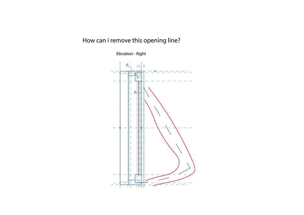

How can i remove Opening line from Window Family?
Probably easy one, but I can't figure it out.
2 ANTWORTEN 2
Nachricht 2 von 3
RDAOU
als Antwort auf: cadedu22
@cadedu22
It is a nested component
  1. Open the Window Family you attached
  2. In Left or Right View Select the opening symbol and EDIT FAMILY
  3. Open the Right/Left view and delete the symbolic lines
  4. Reload back into the window
However, in case you need it for other types later, you do not need to Delete...you can give it a visibility parameter and switch it on and off in the project

Thanks, somehow I didn't notice that it's nested, and was wondering why I can't access certain lines. Now it's clear.
