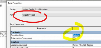

I can set spot elevation tags to be "relative" as opposed to survey point or project base point.
When I look at an elevation marker, I can only select survey point or project base point,   is there a way to
set the to relative as well?

You need to use a Spot Elevations Type that has "Elevation Base" Type Parameter set to "Relative". Then the "Relative Base" on the Options Bar will become active and available when placing an instance of this Spot Elevation Type.

Fair enough.  I would duplicate the Spot Elevation type instead of using Target (Project) type, which normally uses Project Base Point for elevation base.

i have it working now yes,   when I was cutting a section,  I didn't have the "relative" option for level markers,  but if I make spot elveation tags look like lvel markers,  its working for me.

In case you are wondering why Levels don't have Relative option.  Levels are still datum element so it can only based on a higher ranking datum element such as Project Base Point or Survey Point.  Spot elevations are not datum element, but reporting element, therefore they can use all available datum for base (Project Base Point, Survey Point, and Level).
