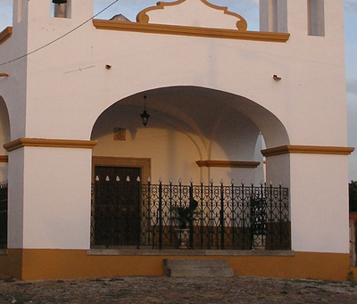

Hey!
I'm making an arch based on a real one, but they end up looking very different.
The one I'm making with Revit starts with a avery abrupt transition from the wall to the top of the arch, while the one I'm taking inspiration from is way smoother closer to the walls and  almost flattens out closer to the top, as you can see in the images below.
How can I make something like this?
1 ANTWORT 1
Nachricht 2 von 2
I actually just found out the best way is through a partial elipse (found in the same place as archs):
