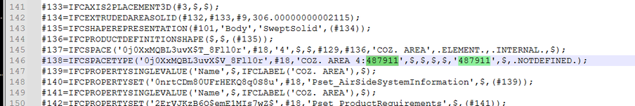

I have a problem exporting an IFC file. There are some rooms that do not appear in the Revit program. These rooms are named Coz. Area or prohibition. Area. I have not named any elements with these names. The names are automatically generated by the revit program.

Fount it!
in the IFC file it gives you the Element ID. from the manage ribbon you can pick Select by ID and put that number in and find it.
In this case it appears to be referring to an Area that is placed in the model.
i feel bad about not catching that earlier :Gesicht_mit_Freudentränen:... .it says right there in your screen capture ( 'COZ, AREA 4: )

But it is correct that they appear with the ifcSpace key after exporting the file.
How do you activate this search by id within revit, please?

Manage ribbon > Select By ID
enter the Element ID
Pick Show or OK.  "Show" will sometimes throw an error that there are not good views, but OK will at least find it for you.
