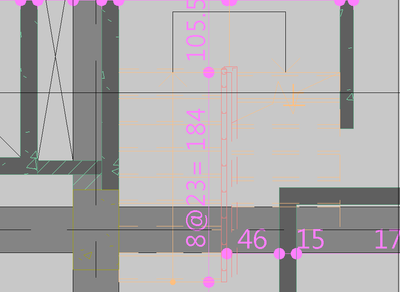

How Can I Draw Stairs according to floor plan
Hello, I'm pretty new in Revit so I have never sketched stairs before tried to look for some things but couldn't quite understand how to exactly.

kalktika
als Antwort auf: barthbradley
when i draw the stairs   which one should i choose as corner like the yellow ones or the red ones

als Antwort auf: kalktika
It looks like a basic stair you can create by draw 2 runs, let's Revit generate the landing automatically, the adjust the landing depth to match your DWG.
