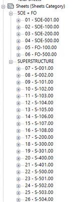

This was useful, I have to add it to this list, is it possible?
Thank you!

You would have to make views that showed the sheet views in the other model (By linked view) and make the corresponding sheets all of which need to be in the referencing model.
