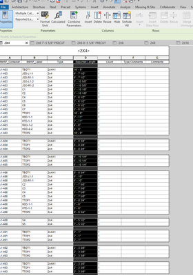

Trying to add up calculated length of studs in a schedule.
I see there is fx calculated tool but not sure what formula I would use?
I'd also like to divide this total by 16'
Any thoughts?
Thank you

I dont want the stud count,   I want to add up all the lengths like 12'-6" + 10'-0"  etc...

Format tab > set the Field to Calculate Totals.

If you just want a total then uncheck itemize on sorting and grouping and on the Formatting tab select Length and Calculate Totals....

this works,   know a good way to divide after totaling?
