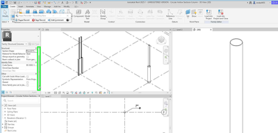

I am trying to add column top and bottom level numbers or level heights to the column tags.
When I edit Column Tag Family and then edit label, there is no parameter related to column top and bottom levels to add to the tag.
I defined some shared parameters, but the problem is that I select parameters from some lists. But those lists do not include column top and bottom levels. Why isn't there such a parameter, it is one of the basics.

I am trying to do what you have shown me also on plan layouts of Level 1 and Level 2:
But spot elevation is not put on plan elevations.
I tried to achieve this by tags but the only information I could fetch into a tag was column length, section heigh etc, not column bottom and top levels. It is below:
Since this is Building Information Modelling, and I have already entered this information, I want to fetch it and do this, automatically. I don't want to write manual information on the plans such as "above" or "below" next to a column. This is time consuming and may be erroneous.

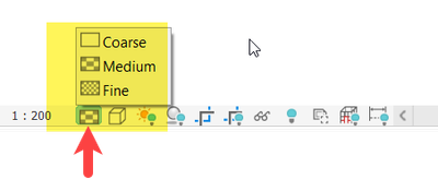

What I want to show on LVL2 is the columns sitting on LVL2 and not continuous below as "above" or as a height range. When I click spot elevation my cursor is a stop sign on LVL 2 everywhere on the plan; doesn't select anything.
May be it is because this is my 10th day on trial and I did something I don't know. I will uninstall and install the software again. It should fix any weird settings.

Is the View Detail Level set to Medium or Fine?  I also went over this above.  Have you read all my replies?

I am sorry Barth, I missed that red text. This solves all the problems.
Thank you very much for your help.
