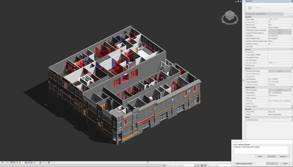

E1. I have an existing building for which I am designing 4 different adaptive reuse schemes. For the most part the facade will remain, but a window might be punched in an exterior wall here or there depending on the scheme; floors and roofs will remain; most interior walls will be fully or partially changed. Assuming I want to maximize the BIMness of this model (e.g. use Worksets & Phases & Design Options & Links) I am confronted with the task of structuring the model geometry in a way that lends itself to all these overlapping layers of organization simultaneously. Once I have modeled the existing conditions and assigned all those elements to the correct phase, workset, etc. should I:
E1a. Place the entire model into one DOS, leaving nothing in the Main Model?

@ToanDNThank you for taking the time to answer some of my questions. I'm still confused about this one:
Q3. What happens (looking for a list of operations Revit performs) when a Secondary DO is promoted to be the Primary DO?
A3: Views with DO set to Automatic will change.
If the only change is which DO is shown in views set to Automatic, why does my model throw so many errors about conflicting elements when I change the Primary DO?
Thanks.
I honestly don't know the answer to this question.  I have made my practice to create all Design Options' elements (primary option, secondary option, thirdary option, no-one-cares option, etc...) in the manner that they must be independent from anything else, including the main model.  With that, I have not seen the error you are showing.

Hi
as far as I can see, there’s a conflict cause of “ wall face split “
try to model simple element , default and avoid complicating model in DO...
one example of errors
1. Main model there’s a wall without windows
2. Option 1- a wall with a window
3. Option 2- a wall with a door
4. Option 3 - only window ( host as main model wall )
in these cases changing any DO as primary is bound to throw some errors..
  1. Conflict between two walls at the same location
  2. Wall face split conflicts when a new window or door comes it
  3. Windows or doors overlap from main model and DO element
Any experienced Revit user/ experts are not worries about Revit, modelling , upcoming problems cause of one main thing “ pop up errors/ warning  “ which reveals the exact problem ... it’s a open book exam in a way...
Most common mistake of new or even some Revit users is to ignore those pop ups and never expand those warnings to understand the root cause..

Thank you @Corsten.Au for approaching the kind of answer(s) I'm looking for here.
This is exactly what I'm talking about. I wan't to understand the root cause of these issues I'm running into, which requires some knowledge of what the program is doing under the hood.
The model I'm currently working with was started by 2 of my coworkers before I began working with it. At least one of them made the mistake of sloppy modeling, not investigating errors, etc. Troubleshooting this existing model is proving more confusing/challenging than doing it right the first time.
On this note, thank you @ToanDN for your suggestions on how to do it right the first time. I will certainly use that organizational scheme whenever I have the opportunity to build a model myself from scratch. As for my current predicament, what are the chances of getting a Revit programmer to weigh in on how the feature is logically structured?
