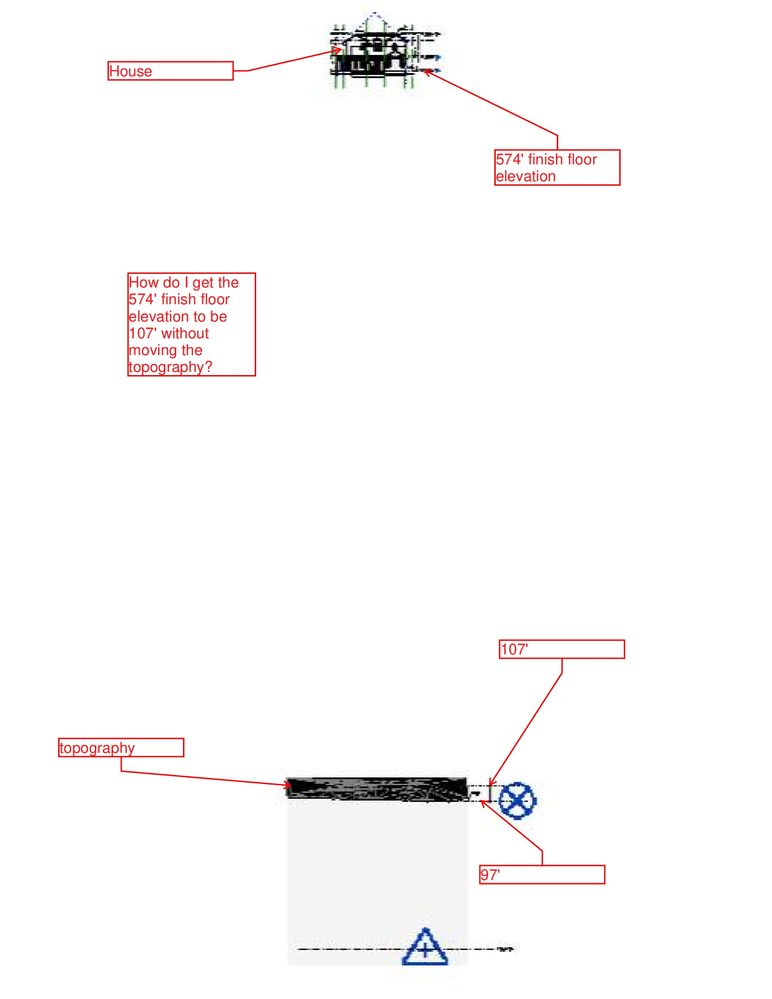

I'm having trouble getting the house level to work with the topography.  The topography was created with absolute elevation points.  The house levels were adjusted by relocating the project relative to Survey point.  However the topography is way off, no matter how I try to adjust the survey point or the Base project point.
Am I supposed to just separate out the topography as a separate file and then import?  What is to most logical solution?

The topography is at 97' elevation but the house 1st floor elevation is sitting at 574'.
The topography elevation is where it needs to be, but I need the house elevation to be 107'.
How do I do this without having to move the entire house manually?

als Antwort auf: JKspace424
Do you need something like this?
@JKspace424 wrote:
Yes
If you create it from scratch then go to an elevation and move the survey point 107' down from the project base point, the change the level type to reference survey point.
if you already have things drawn, then post a srceenshot of the elevation similar to what I show so I can see where things stand.

how do I get the house to be at 107' without the topography elevation changedFull page photo.jpg
- Un-clip the project base point, grab the blue group in the pic 1 below, and move it up 467'
- Re-clip the project base point
- Edit the Level type and change Elevation Base to Survey point (pic 2)
- If you need to annotate the topo contour label to show the true elevation, then go to a site plan, edit the contour label type and change Elevation base to Survey Point (Pic 3)

My understanding at this moment is that the "absolute elevation" points that were created on the topography can not be adjusted to the current survey point or project base point.
When I try to adjust or modify the topography, the 97' elevation (which show up correctly as 97' with spot elevation call-outs) is now at 563.77' when I highlight a point in edit mode.  I guess when I start the grading the topography would just have to be put into another file for proper editing and imported back into the house file.  Am I correct to think this way?

It is recommended to have the topo in a separate file but it is not a must.  You can still see the topo points with the absolute elevation value (as when you start placing them) when moving the project base point and survey point to where your project requires.  Keep in mind that the only thing absolute in a Revit model is the Origin Point, not Project base Point, not Survey Point.  Everything else is relative to the Origin Point or to one another.
See screencast for a demonstration on how to keep the topo and moving the SP and PBP:
