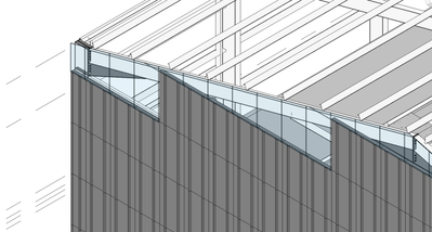

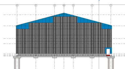

Hi Everyone, I am modeling a portal frame with insulted roof panels. I have the insulated wall panels as a family. I created the wall with curtain wall and used Select Panels on Host to embed the family inside the wall. However, it wont cut panels at an angel to tie in with portal gable layout and places the rectangular panels correctly . I have attached a photo that shows this. Would appreciate if some can help our show an alternative way of doing it.

Why don't you use System Curtain Panels?  Be so much faster and easier.  But, if you want to go this route, then yes, you'll need to design custom panels.

How do i do that. I just want to be able to create a corrugated wall panel?

I'm saying to use the "System" Curtain Panel in lieu of a Loadable Curtain Panel.  The System Panel will automatically conform to any opening shape -- polygonal or curved.  As for the material, you can assign whatever Appearence, Thermal and Physical Properties you want to the System Panel. Revit even has a corrugated box rib Appearance Asset you could use.
one more 4 u:
