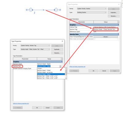

Nachricht 3 von 3
als Antwort auf: josue777torsan
I think I know what you did. You defined the Section Tail to be a Head.  Select the Section and edit it as shown below to change the Section Tail to a SECTION TAIL in the dropdown.
...and then follow my orignal instructions to CYCLE from nothing to Head to Tail.
