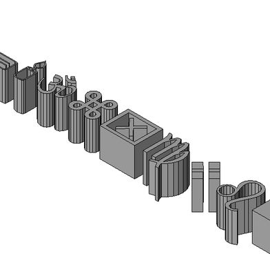

Hi, as said, I used this font method a while back for graphics design in Page maker, and it worked...
Today I test your idea in my Rv17, windows 10, attached.
I created text style Wingdings, available in Rv.
Made 3D and 2D text. The 3d text (above) don't render the same characters as I wanted (a simple band) as seen in 2d text (below).
Did I miss anything ? I did typed in character codes, but still return boxes in 3d.
Nachricht 7 von 13
syman2000
als Antwort auf: yes_and_no
The 3d model text and 2d text will be different. 3d model text require you to give it text height to make it show as 2d thickness.

I am not understanding what you want to achieve. You want 2d black text to be the same as the model text color or something else? If it is different character, then you have to create a different type.

Hi, perhaps you missed my posts, I already created new text style for
Wingdings font, and the 2d and 3d text characters are not rendered the
same. The 2d came out ok, but the 3d only returns boxes (yes, it IS in
Wingdings style)

If it isn't rendering properly, then certain character you have to avoid. Revit is not going to give you everything like magic. You have to experiment and mix what works well to give you the effect you want. What I'm putting up is what I've used as font in the past and it works well for my criteria. This is why I share the idea to see if that method works well without having to remodel those detail. If it doesn't work for you, then pick other options.
