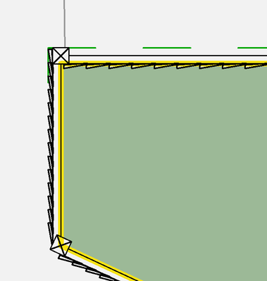

I have an area (green) and have hidden the boundary in Visibility / Graphics but when I disable Thin Lines, I get this yellow border around the area where the boundary was.
Is there any way to hide or delete this as it is rather distracting.

What is the green area?
Nachricht 3 von 13
als Antwort auf: BugFinder
Turn off Lines: Area Boundary

The green part is the edge of an Area

Area boundary is already turned off which is why I was suprised to see something here

Do you still it if you turn off Area?

Perhaps an override acting on it in the view?  Dunno. Post the file.  We'll get to the bottom of it.

Try turning off Interior fill

I've attached the file.  Tried disabling a few bits here and there but no luck!!

Ok, I must have got some bit mixed up here ...:verwirrtes_Gesicht:
What's the difference between color and interior fill?

Color fill is use for color scheme. Interior infill is rarely used unless you are doing a lot of quality control and ensure your area object is filled inside the area boundary lines.
