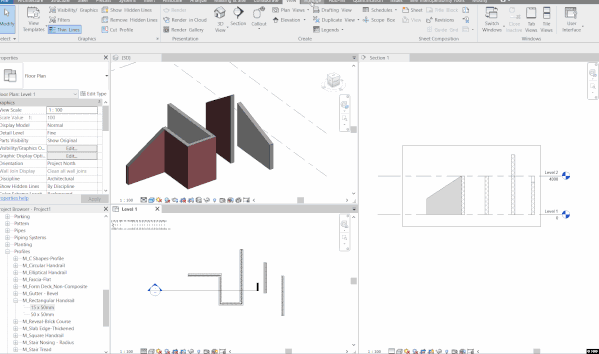

Manually does not mean you redraw everything..you simply add what you have now to 2 design options...I will edit this post in a minute and add a gif
Edit: See GIF below
Nachricht 9 von 9

Sorry, I misunderstood that post when you wrote that we need to do something similar with design options, like you described in first option with worksets.
Yes, I just tryed that and it works! Thank you mate! There will be some errors while adding to set constrained and joined walls, and errors about overlapping, but this is it.
