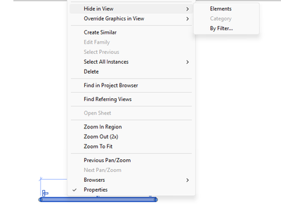

Can only hide in view by single element. Category is greyed out. Have tried in multiple view types all with the same issue. Project is not linked.
Ideas?

When you use the right button and check hide by category, it's the same as if you go into VG and uncheck the visibility of that category.
So, without further details, the closest I can think is that a view template is applied.
Check if that's the case.

payingtoomuch
Thanks Arc42.
So if I have a view template assigned to a view I can only hide individual components and not categories? If so, is there a way to temporarily override this?

If you have a template applied, you cannot modify anything that is determined by the template.
For any template, you can decide what is and is or is not included in the template overrides. For example, you can apply a template to multiple views but select a different scale for each one, or deactivate "underlay orientation" to apply it individually by view.
And, yes, you can temporarily override view templates with "enable temporary view properties." (add a shortcut like VC to it)
You can also temporarily apply other view templates you've already set up with "Temporarily apply template properties."
Clicking on the same icon (or typing the shortcut again) disables the temporary properties/template.

payingtoomuch
Awesome! Now I have a good reason to click on that button! Never realized I could do that. Even more awesomeness with that approach is that it enables the "hide by category" feature that is greyed back when I'm in the normal view. Perfect!
