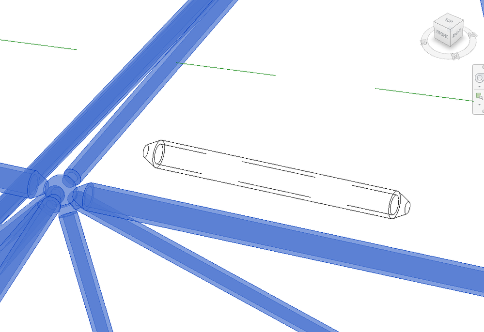

I think we've found a problem when working with Revit Links.
When setting the view parameter "Show Hidden Lines" to "All", every hidden line in the linked model is controlled by the subcategory "Walls-Hidden Lines". I attach some pics to show the problem. In the first one you can see the linked model selected and a Structural Framing that I've created in the document (not selected).  In the next pics you can see the "Visibility/Graphics Overrides" that I have defined and the result in the model. As you can see the hidden lines of the linked model are no longer controlable through the "Hidden Lines" subcategory contained in the corresponding category.
Can we do anything to fix this issue?
