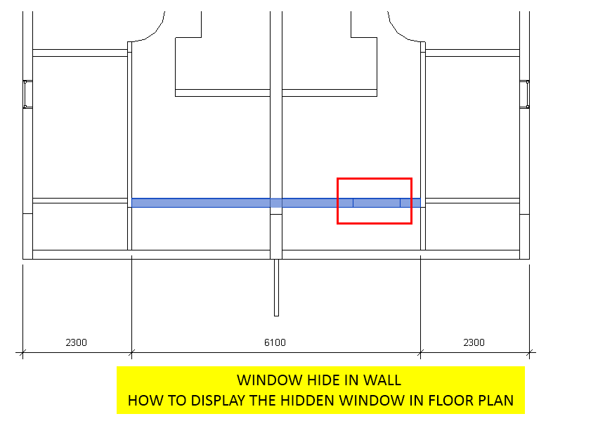

hiii geniuses,

MostafaElashmawy
you need the cut plane of the view range to pass by the window.
adjust the cut plane level.

martijn_pater
Click Reveal hidden elements at the bottom of your screen. Right-click the window and Unhide in view.
Reveal Hidden ElementsReveal Hidden Elements
Else check the following link to set your Visibility Graphics correctly: https://www.ideateinc.com/blog/2013/01/missing-something-in-revit-view-33  (edit: could very well be #5 mentioned above actually)
