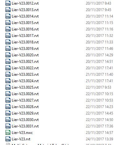

Revit automitically creates backup files.
Search in your folder for the files with .000x behind it.

@-FDC-: Those aren't automatic saves; they are backups created when you manually save.
