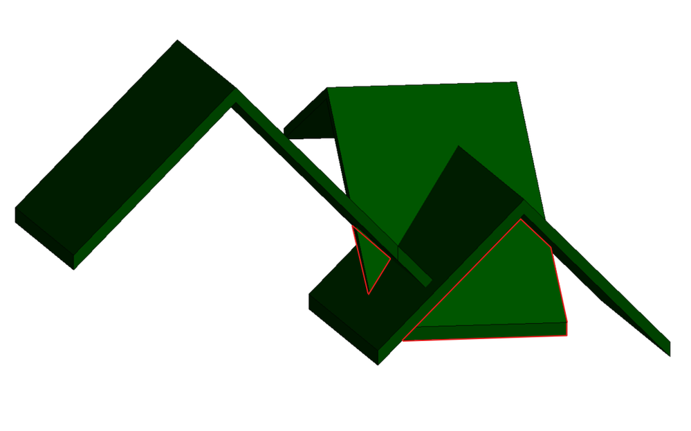

Hi Everyone!
I'm currently struggling with cleaning up some complex roof geometry. I was planning on using the roof opening by face tool to be able to clean up the roof underneath where it intersects with another roof.
In the photos below, I have outlined the area I am trying to get rid of, and put arrows along the edge I would like to be able to select. When I'm using the roof opening tool, I can't seem to select the spot where these two roofs intersect. I know I could use the cut tool to get a cut along that line, but then the remaining roof is left underneath still. Any advice would be very useful! Thank you in advance.

Join them all together and then cut the protruding portion with an In-Place Modeled Void Extrusion.
