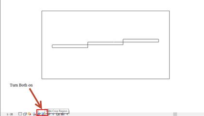

When i use assemblies in a 3D view of a model and create a split segment section, the software create the right section but strangely rotat its view in horizontal and i can't get it in a sheet because it's uncorrect.
It is like that Revit when i split the segment generate a different section property but i can't find a solution.

Yah, I can see it is happening,  don't know why. Its happening only when you creates section views directly from the assembly views.
Step-1: One thing you can do now that go to your desire section view after split segment.
Step-2: Turn on the "Crop view and Crop Region visible".
Step-3: Select the crop region and rotate it.
** You have to rotate the region in opposite direction, in which direction you want to rotate the view.
It is not a proper solution, but hope your problem will solve.
