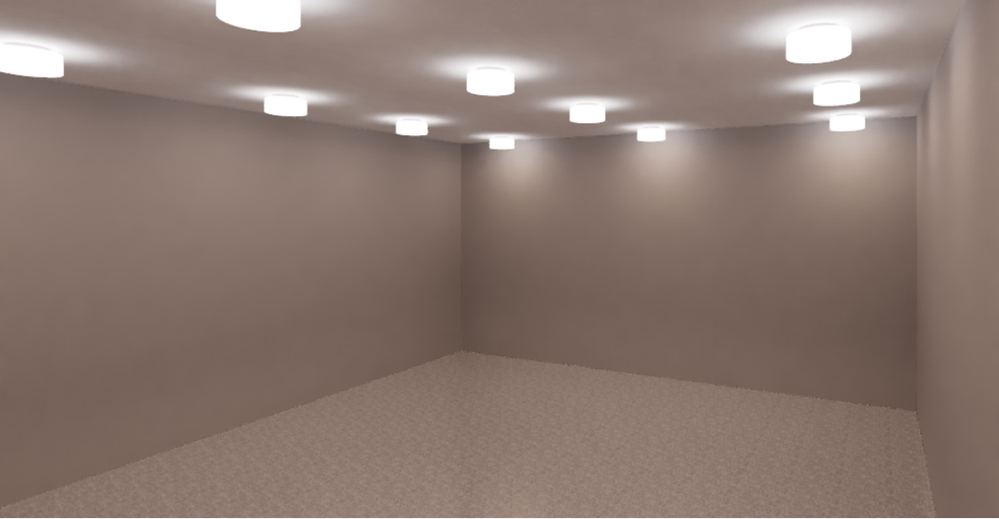

Hello! I have been having the same issue in all my projects for a couple weeks now. My lighting families have all become extremely dim. Doesn't matter which project I'm working in, so its not a settings issue within the project. Nothing changes when I go into the lighting family and change the parameters such as intensity or wattage.
I have set up a quick example so you can see what I'm talking about.
Photo 1 is a room that is 15'-4" x 19'-4" I have placed 18 of the Revit stock family "Downlight Recessed Can- 6" Incandescent 277v" the family has not been messed with so it should still have all of the same default properties
(60 W/ 14.25 lm, Light Loss Factor 1, and 2800 K)
Photo 2 is the same room, same amount of lights, but I changed with wattage to 150 W and 50 lm. The room looks exactly the same. I even renamed the family and replaced all the lights.
It doesn't matter what lighting family I use (from BIM Object or Revit), the intensity is always the same, no matter the project I'm working in, and no matter the family. Here's a third example using 15 of the default Revit family "Ceiling Light- Flat Round 60 W- 120 V"
At this point I think my best bet is to uninstall Revit and reinstall it again? I'm not really sure where to even start in fixing this issue. It wasn't always like this. Now rendering is next to impossible. Any help is appreciated!!

You know what I bet? The diffuser Material is Self-Illuminating, and you are confusing that Material Property with Light.  There is no correlation between the two.

This was actually my first thought, that somehow the lighting families were self illuminating and not allowing the lumen to shine through. Even when I change the lighting family material to glass, it appears exactly the same when reloaded into the project. Any changes made are not showing!

No Rendering issues here and the light fixtures respond appropriately to different Photometric values.
Maybe try different exposure settings...

Well that is interesting... Adjusting the exposure is how I've gotten by the past few weeks, but with the project I'm working on now some areas (like the windows) just blow out too much. I guess it's more of a technical issue on my end.. Thanks for your help

So I decided to render this image in the cloud and this is how it turned out...
What's up with that?

I mean why would the image render seemingly normal when rendered in the cloud, but when rendered at high (or any other) quality in Revit it renders very poorly and does not show any changes made to the family? I'm happy the problem seems to subside when rendering in the cloud but it is not very time effective as rendering in the cloud can take a lot longer. Especially when I'm making small adjustments and wanting to see the results quickly in Revit.

You're comparing apple and oranges, @hp248.  Local and Cloud rendering are two different technologies.
