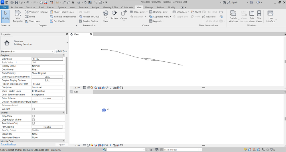

I'm trying to create a surface in Revit. I import a surface to revit from civil 3d , this surface was created from polylines. In Revit i notice that level curves loses smothing,. MY problem here  is that i decide to unload DWG, beacuse that  have already created , but when did it , i couldn´t see that surface in 3d model , but in east view yes. So someone could help to watch this surface. Other question is about what is the best form to create a surface for a project.help terrain.png

If you are not seeing it in Plan View, then it is not within the View Range. Probably way above it.  Change your View Range settings to capture the elements - or move the element up or down in Elevation View.
...you could change the Upper and Lower View Ranges to "Unlimited".
....here's a cheat-sheet to reference when you can't see stuff in the View:
https://www.revitforum.org/node/459
