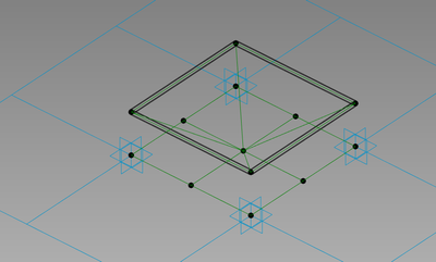

Thanks for the help, I did it and it worked. But now, the other problem :grinsendes_Gesicht_mit_Schweißperlen: of the tridimentional truss. I did a family for the structure of the panel with the template Metric Curtain Panel Pattern Based, and I load it in the project days ago to test it. And now when I try to load it in the project that I created, it appears an error. I tried to save it with another name and also created a new one from scratch.Captura de pantalla 2022-10-15 134402.jpgerror3.jpgError.jpg

You can test the family flex by changing the  tile spacing.  Here shows some points are not hosted/constrained properly.
I fixed the points and skeleton frame for you.  You can recreate the rods from them.

als Antwort auf: admeza
I have fixed your curtain pattern family again but I would recommend to use an adaptive generic family with repeater.  It gives a better result.  Both are attached and the image below is using the adaptive family.
