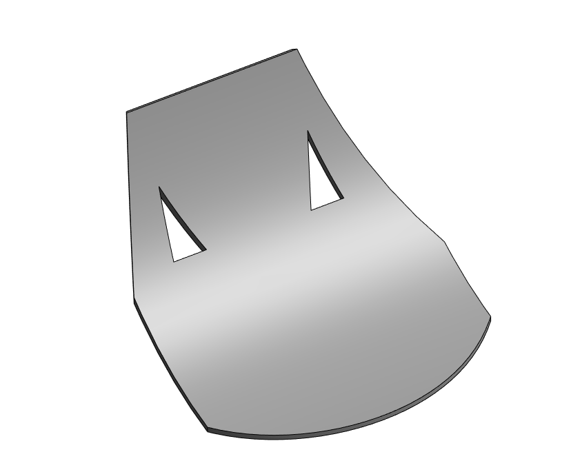

I had a bit of a play, I couldn't open your file but this would hopefully illustrate roughly what I was thinking...
