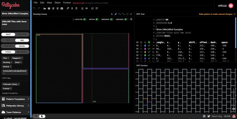

Anyone can help me on this i need 240X160X3mm gap but i can't get this pattern in revit

I would suggest https://pattycake.io/pat
Check it out.. its online and very intuitive..
Its a really great tool.
Cheers, K

Made with our DXF to PAT generator. If you are having problems with understanding the platform, please reach out hi@pattycake.io --- we are always looking for ways to improve the service :daumen_hoch:
One complex (with 3mm grout): https://pattycake.io/official/pat/YlVLdmAXyEM
One simple (without grout): https://pattycake.io/official/pat/v2A3m8vw18e
Think you might want to use the without grout for documentation... 3mm joints are a bit too dense and wont read depending on scale. The simple one has tiles 163x243 to accurately represent CL of grout to CL of grout.
