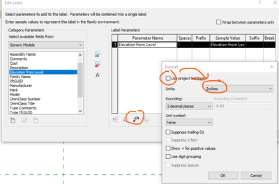

You can't. But what about a Tag?

Yes! That works even better, my only issue is that we usually work with feet and fractional inches, but when it comes to fixture heights we use inches. Is there a way to make the tag report that height in inches without modifying the overall project units?

Edit the tag label > format units > and change it to inches or fractional inches depends on your standards.
