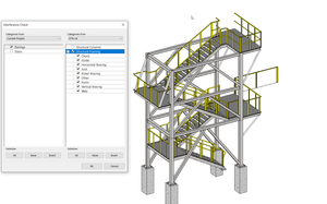

Hi Every one hope you all of you doing well . i have issue with the railing baluster post actualy i need to cut the railing steel L angle post which having a clash with steel stringer  and have to add pas plate also. My case is i have stair in structural model and railing is in arch model both are in different file  but i have to do cut at that correct place where its getting clash with stringer kindly help me to solve this. i have attached pic below no. 1 indicates what am having issue No.2 indicate i have to do same as like this detail.
Thank you advance
NO.1NO.1
No.2No.2

You may want to edit the baluster family and add void to cut the bottom portion
Nachricht 3 von 23
als Antwort auf: jpkottai
Is the Railing actually hosted to the Supports? If so, does adjusting the Railing's "Offset from Path" fix?
Nachricht 4 von 23
Ah! I see now what you are up against. What about a "reference" Support in the Arch to "cut" and Railing and then hide this reference in the View(s)?

Balusters only attach to stringers, not structural framing.  If you need them to cut at an angle then copy paste the stair aligned in place, then add stringers to the copy stair and host railing on that stair.  Then you can hide that stair and you can have the railing.

Worst case, you can remove all balusters from the railing and place them manually as structural column or structural framing, then you can trim them with reference planes.

I don't understand the design intent, but my understanding was that you wanted to cut the balusters at an angle at the stairs. If so, I'm doubly confounded by all the base offsets built into the Railing Types' Baluster Patterns. I'm thinking they were your attempts to find a workaround.
Try this workaround. No base offsets and balusters are constrained at top and bottom to "reference" rails defined under Rail Structure.

play with these height values to control where cut is made (essentially the baluster "offset"):

Get rid of the kickers and there's no clashes.  So, the issue is not the balusters.  My revised railing works fine.
Nachricht 19 von 23
Change the Kicker Plate Height and edit the sketch to shorten it slightly.
Then figure out how to resolve this one remaining clash:
