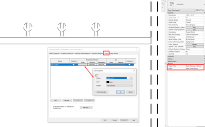

I'm sure this is simple but, I can't figure out how to have my electrical outlets and/or lighting fixtures to show up dashed in plan when they are being removed.  It's my first electrical and RCP plan in Revit.  Thanks for the assistance!

I figured out why most electrical outlets were not showing up dashed and have fixed it (per above).  Now my data port isn't showing up dashed.  I think this is just because the line segments are too long for whatever dashed line I have it set to.  I would like the 2 electrical outlets and the data (top symbols in the attached image...the bottom one should stay as is) to show up with smaller dashed lines than what it is currently.  I'm not sure how to set it and/or override the electrical to a smaller dashed line that it is right now.

Nachricht 10 von 17
als Antwort auf: Anonymous
@Anonymous wrote:
Won't that override ALL of the demo elements? I'd like the walls to remain the way I have them but the electrical to be a smaller dash.
Sure will.  Use Graphic Overrides in the View then.
...you can do it as a Filter so can apply the Filter to other like Views.

Maybe I'm missing something or maybe what I'm trying to do is not possible.  Whatever overrides I try it affects ALL electrical (new, existing AND demo).  I'm not well versed in using the filters so maybe this is the answer to a smaller dash in the demolished electrical only?  I'm still not exactly sure how to have it affect ONLY the demolished electrical and data outlets. Thanks for your help everyone who has answered thus far!

If  you want that much modular changes for visibility based on phases I suggest you upgrade the model to Revit 2022 as they opened up the phase created and demoed parameters to filters.
Nachricht 15 von 17
Employ the "Phase Demolished" in your Filter Rules.
...okay, I get that you DO NOT have 2022. I misread.  Filter by another Rule then; maybe Comments.  Or, instead of Rule-Based Filter, maybe use a Selection Filter.
Nachricht 16 von 17
als Antwort auf: barthbradley
Barthbradley.  This worked (and now you are my favorite person).  Thanks all for your helping this Revit newbie!!
