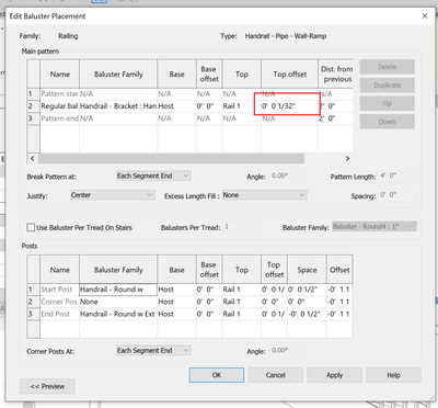

I am using a handrail I found in the "Railing Samples"  in one of my own projects. I am having problems with the returns at the top and the bottom, also the supports are not connected to the handrail. I am attaching a few photos.

I change this value and it seems to line up. If the value is zero, it is offset by 1 1/2". So something is going on inside that start & end balusters

Thank you, that works for me also. Now, how about these supports that don't hit the handrail.Screenshot 2023-07-19 192805.png

Just add top offset a small value and it should placed them at the right height.

That did work, Thank You.
